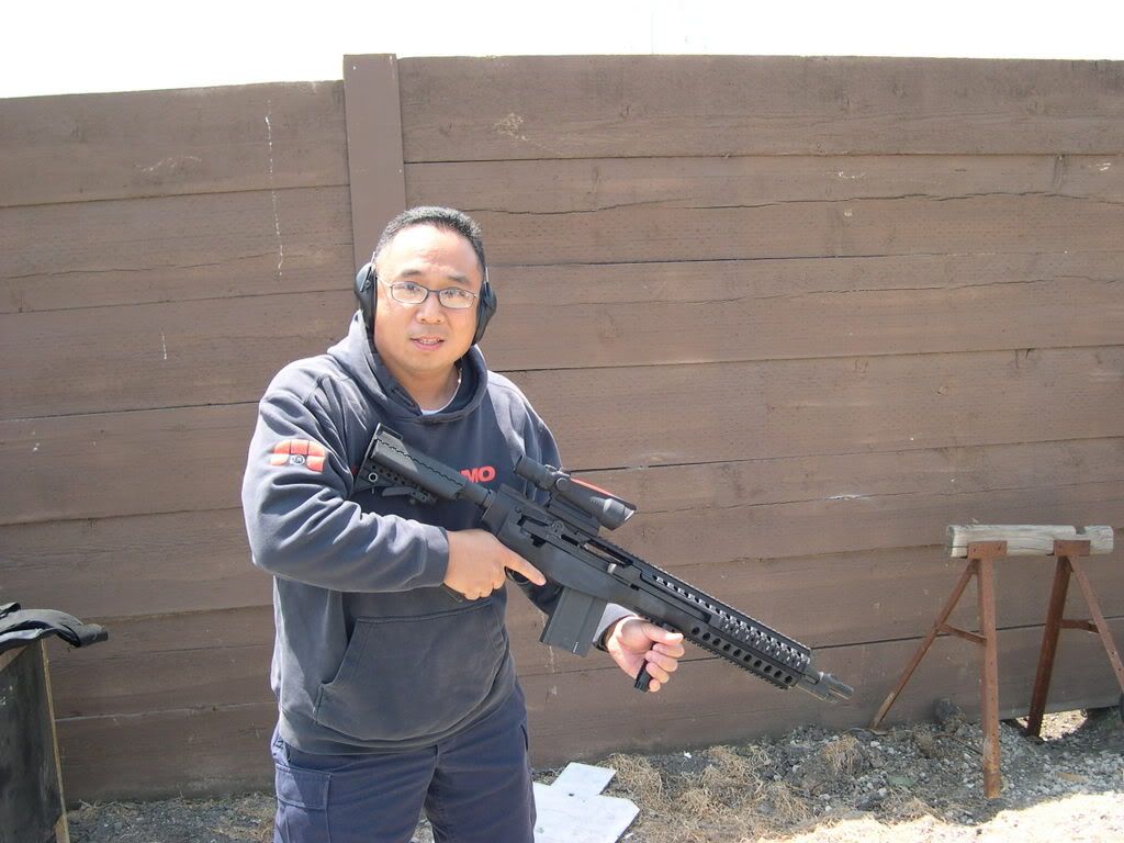

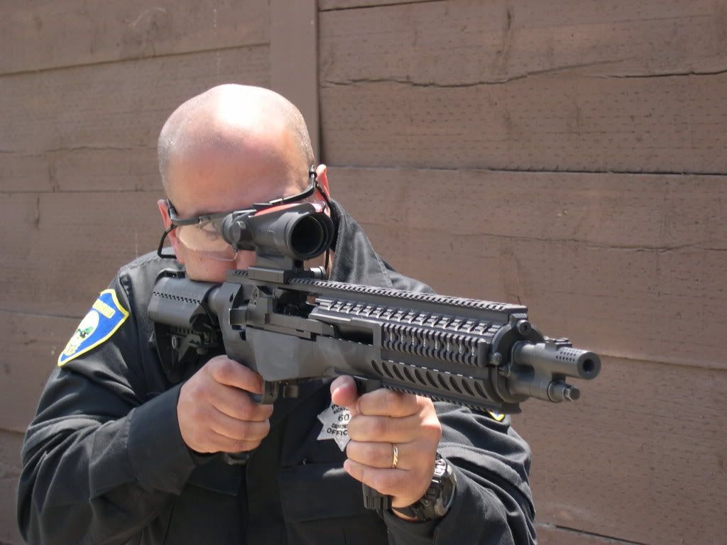

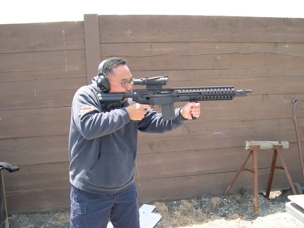

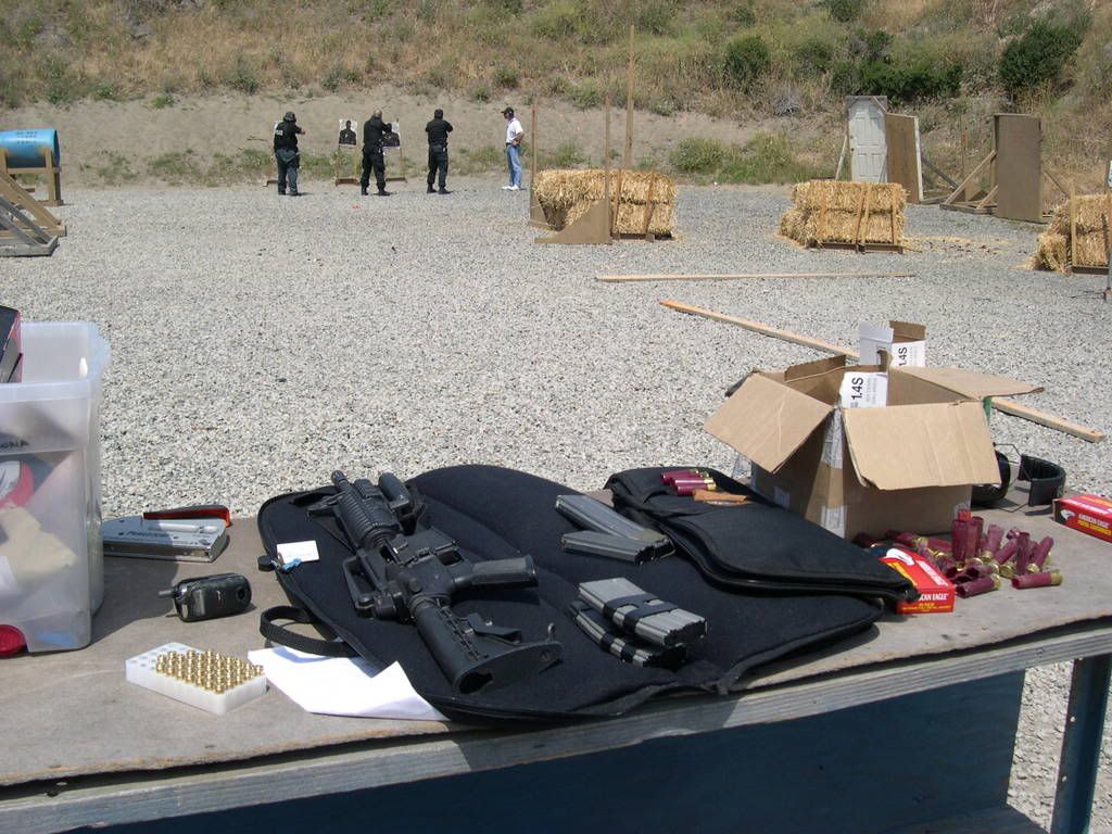

Here are some pictures of the Springfield Armory Socom 16 with the new Troy MCS stock assembly. My friend wanted me to show pictures of the Troy MCS in action during a monthly range training for the Richmond P.D. This stock is a main competitor to the Sage stock systems for the M14. In essence, the Troy MCS turns the handling of the M14 rifle similar to the M4's (with some added weight).

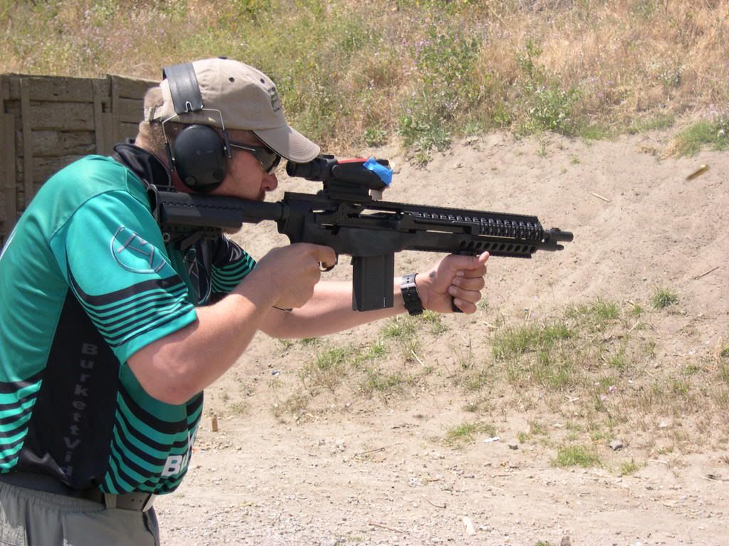

Is that Matt Burkett shooting in the last picture with the front cover of the Trijicon taped over? Its a good training technique
Yup, that was Matt Burkett. He was conducting his own training session at the adjacent range. He heard us training with our entry guns (M4's and 11.5 carbines) and came over to see. He was showing some of my co-workers how the BAC (BIndon Aiming Concept) works by taping up the ACOG's front lense. He was impressed with the Troy MCS, and he stated that the MCS handled better than the Sage, and was faster to index towards the varies targets we had.

Ducman said:
How did you find the balance of the Troy? The Socom that I had was nice balanced in its stock config, but with the rails it was very front heavy, making tranisition slow and heavy.
As far as balance, the stock Socom 16 is more neutral in feel. The Socom 2 (with the rail and gadgets) feels more front heavy.
A Sage equiped M14 is about the same as a Socom 2. The Troy set up isn't as much. When compared to SOme of my co-workers M4s with all their gadgets on it, the Troy MCS Socom is about the same weight, but it's firing a more powerful round (7.62 X 51 Nato). It doesn't take much to get use to it.:cool:
